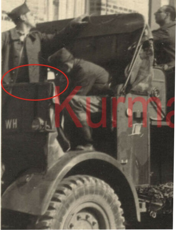

Hi Sturm,
If you look at the form of the mudguards the side lamps and the strange shape and the position of the fuel tank I can be pretty sure. Some later BY3s had a more conventional fuel tank above the running board to the rear of the cab, but the high, almost square ended, tank with a cap, or possibly gauge, on the end is very Albion.

Hi guys,
The thing is Albion BY3 for sure, there are enough ID points to nail it.
Re: ► Photothread: British Vehicles in German Service
Thank you for your confirmation. However, I would be uncomfortable with the id of BY3 as the photo is taken around the time of the Dunkirk evacuations, so May/June 1940( note the French or Belgian soldiers in and on the truck). The upgrade from BY1 to BY3, officially, was made when production of the BY3 began in June 1940. The major change between the models was the exchange of the 64hp four cylinder EN215 motor for the 80hp six cylinder EN278, plus some gearbox changes. Externally they remained much the same. I think that it is highly unlikely for this reason to be a BY3, which was produced between 1940 and 1941, before being replaced by the BY5 with the six cylinder EN280. Again, somewhat similar in external appearance to the BY3, although both BY3 and BY5 were produced with an optional enclosed cab and with full windscreens.
My money is on a BY1 for these reasons.

Hi Kerry anmd ilfil
The position of the fuel tank made me doubt. Albion BY, therefore
Well, let it be BY1 then, the fuel tank is where it must be for the early model. But why I can't see that typical for BY1s whole width "railing"?
The most obvious, if flippant, answer is you cannot see it because it isn't there. I do not know if the full width grab-bar was purpose-specific, but most photos show a short, single, bar in front of the driver. If you have Les Freathy or Jochen Vollert's superb Tankograd books you will see that all photos show this single type. In fact the model preceding the BY series, the Model 32, not only had the single bar, it also had no weather protection for the passenger, only the provision of a canvas blanket and a seat squab!
The complexity of the British "standardised" 3-ton range is sufficient to fill a book of it's own and I am just at the start of learning some of it's mysteries.
Regards,
Regards,
