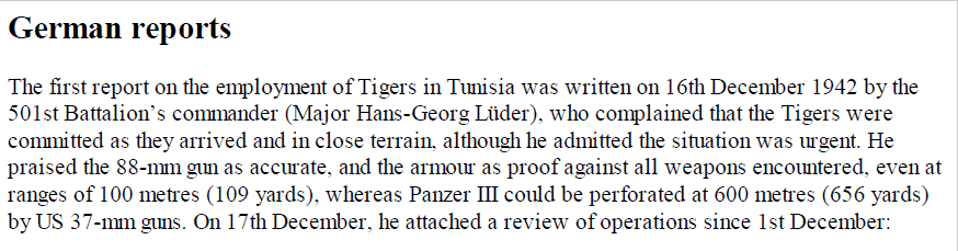

Post by Peasant » 18 Feb 2023 10:46
Source: "The Tiger Tank and Allied Intelligence Vol.III p.330"
Interestingly the quoted figure (600m) is almost exactly in line with one obtained by british in testing, which lends credibility to it and opens up a possibility that germans had also tested the US 37mm gun (they had captured plenty of M3 Stuart tanks in NA) against some wrecked Pz.IIIs
