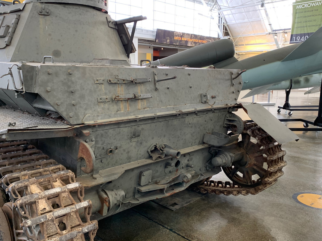

I have attached some photos of vehicles from the Flying Heritage Combat Arms Museum. The Pz.IV and Pz.Jg.38t both show some marks or damage on the body. I'm curious if anyone knows what would cause these marks? The Pz.IV is in pretty rough shape - it's the Littlefield Pz.IV that was acquired from the Syrian war - but the Pz.Jg.38t was built after the war, using parts from damaged vehicles, so it hasn't seen action since assembly I would presume.
The marks are the small gouges on the Pz.IV around the open access covers, and the all over the side of the 38t. The 38t has similar marks on other surfaces.

I would guess it was jack-hammered to remove zimmerit. But the Pz.Jg.38t never had zimmerit? It isn't battle damage.

I believe it is done during the manufacture of the rolled plate. It is hammered to relieve stress on the plate so that it doesn't warp. Something like that.

If you look at the Jgp 38t the marks are not all over that plate. Zoom in and you will see they are in vertical bands.
I suspect that since they are both thin plates for each vehicle, it might be some fitment method to bend the plate.
Re: Help identify damage on museum Pz.IV and Pz.Jg.38T
yeah, there is a "sinuous" quality to it - definitely some pattern as it moves, whereas the pzIV looks much more like random. There are more marks on the body of the PzIV, but they don't display this pattern either.
Also interesting is that, from the recent thread on the 38t armor quality ( viewtopic.php?f=47&t=252143 ) , the 38t armor was not hardened to the same degree as the pzIV but the marks look very similar. Perhaps that doesn't really matter in this case though - I don't know much about metal or armor.

Identical jams have LT vz. 35 floods from Aberdeen (USA). Today in Czech republic. But the jams are also on Pz. Kpfw. IV located in Syria (French machines).
This same jams discussion. https://www.valka.cz/CZK-LT-vz-35-t11691
