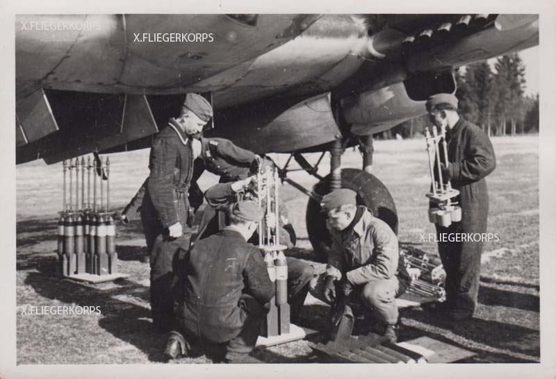

Another image from Ebay. Any idea about the bomb loaded in central position ?
- Posts: 931
- Joined: 11 Jul 2005 14:55
- Location: Poland
- Posts: 2
- Joined: 22 Nov 2021 02:34
- Location: St Louis
Re: Id. aerial bombs
maybe an SC 2500
- Posts: 17265
- Joined: 02 Oct 2008 17:18
- Location: Spain
Ummhhh.. Perhaps you are right...The SD500C bomb have a more rounded nose than the rest of SD500 models...A pity that the rear part of the bomb is cannot appreciate....Grzesio wrote
Looks like an SD 500 C.
I guess than the other two bombs are SC250 bombs, is it not ?
