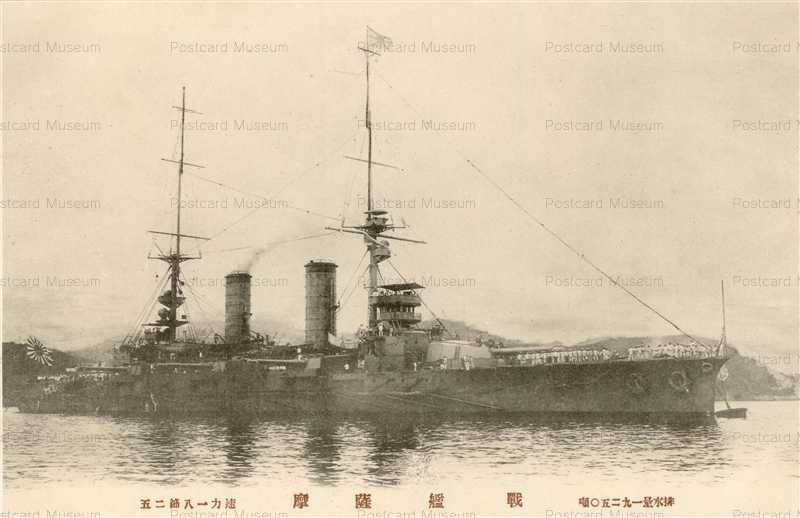

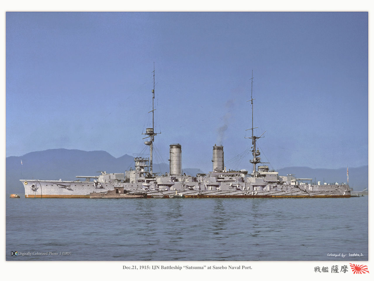

Studying your comments and all details of the pictures posted here and according with drawings of Hans Lengerer and Lars Ahlberg book "Armourclad Fuso to Kongo Class Battlecruisers", I can say the unknown warship of the postard is almost certainly battleship Satsuma.
It is a view from stern: the after main gun turret, the height of crows nest of the main mast comparable with height of the two funnels, the searchlights below the crows nest, the shapes and position of aft bridge close to main mast, the position of cross mast and crows nest of the foremast, the boat davit, the pillar close to main guns...
Aki had three stacks and minor details don't match with Sturm78's postcard.
Could it be battleship Satsuma in Meiji era?
Satsuma with Vice Admiral's flag. (Kamimura Hikonojo?)
Kind regards,
Canoga
