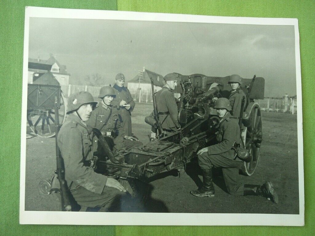

Posts: 16882
Re: What is this gun?
Post by Sturm78 » 04 Jan 2022 18:21
An image from Ebay:
