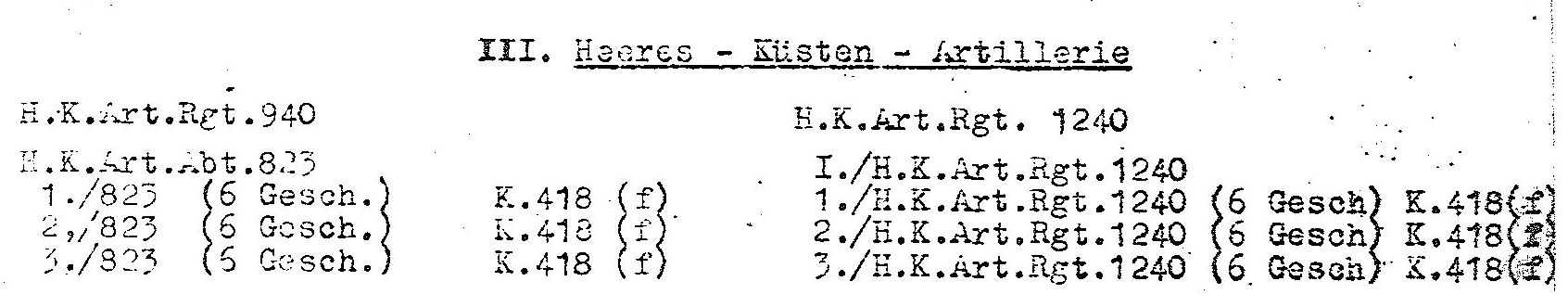

when were the guns of 2./823 changed? Because 823 were creted with 3 batteries of each 6 x 15,5 cm k. 418 (f)
Uwe

i wonder because at Dec 19th 1943 - Org.Abt. order says about the guns at 823 all 15,5 cm K. 418 (f)
so maybe the change from 418 to 416 were an unauthorisized change?
or just an Org.Abt. typo?
Uwe

All local German information and photo's indicates a 15.5 cm K.416(f) , strange is also that in
1944 the 2./1240 with 15.5 cm K.416(f) was rearmed with 6 x 8.35 M.22 (t) only this battery.
Regards Jos
