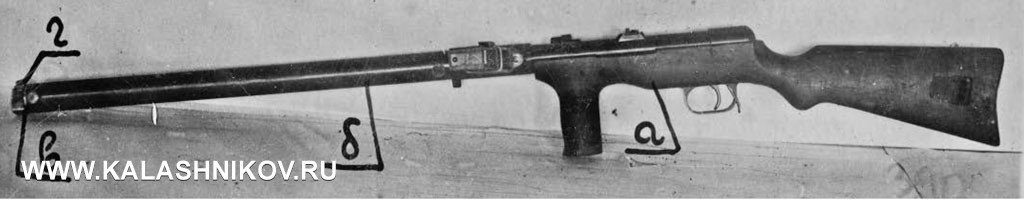

Yes. The soviets and partisans used bramit devices on mosin nagant rifles and nagant revolvers. Silenced rifles captured by the germans were given the designation "partisanengewehr". Soviets experimented with silenced PPDs and PPSh submachineguns, but nothing became of it and they just remained prototypes. Additionally, a silenced version of the ERMA EMP saw service with the Brandenburgers, one of which was captured and tested by the Soviets in late 1941. To add to that, Kommandoverband "Jaguar" used silenced MP40s, presumably with EMP-style silencers.
