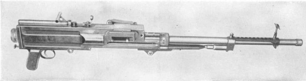

Post by kerryboo » 12 Jan 2016 21:27
I do not think that this is a German weapon, but, beyond that, I have no notion of what it may be. It is one of quite a few unknown weapon photos in my collection.
Thanks for looking,
ROLAND1369
Posts: 1011
Joined: 26 May 2007 15:22
Re: Photos - Germans with captured firearms
Post by ROLAND1369 » 13 Jan 2016 14:57
I believe that this is a expedient ground mounted French 7.5 MM mac 1934 fixed aircraft gun. It has been fitte with a nonstandard flash hider usually seen on the m1914 Hotchkiss MMG I am afraid that I do not know where on the internet I got the photo.

LineDoggie
Posts: 405
Joined: 03 Oct 2008 20:06
Post by LineDoggie » 15 Jan 2016 05:56

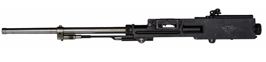

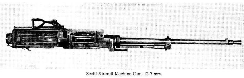

kerryboo wrote:I do not think that this is a German weapon, but, beyond that, I have no notion of what it may be. It is one of quite a few unknown weapon photos in my collection.
Thanks for looking,
Italian
Scotti Aircraft machinegun
Looks to be the 12.7mm version
here's images of both-

Post by kerryboo » 15 Jan 2016 10:29
Thank you, Markus and LineDoggie,
