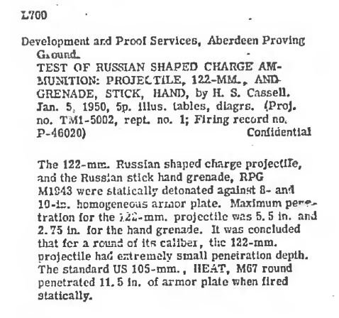

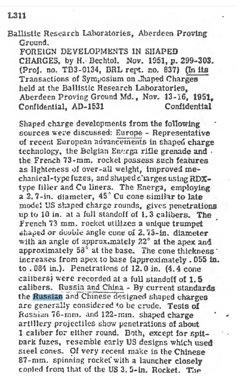

There is so little data on these available, that every bit counts. This is from a US document dated 1951:

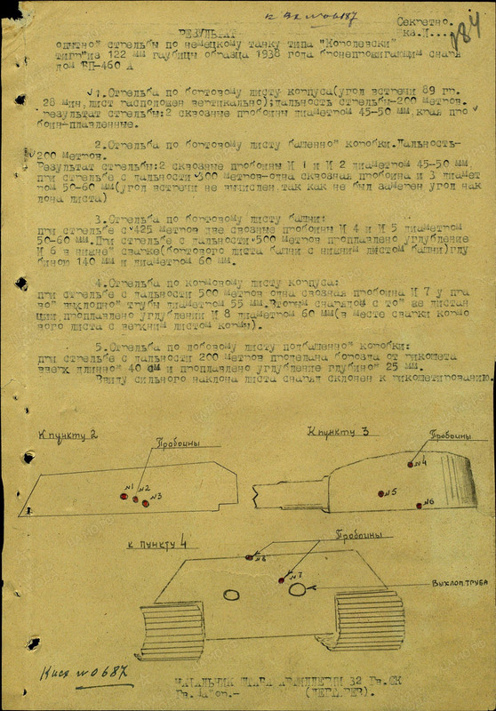

Edit: Found a document describing testing of the 122mm BP-460A HEAT shell vs a King Tiger. To keep it short: all 90° hits to the hull side, superstructure, turret and hull rear penetrated the armour leaving 45-60mm diameter holes. In one instance the shell hit the lower edge of the turret and made a hole in the turret side and a gash in the turret floor, of combined depth of 140mm. A single shot at the UFP left a dent 40mm long, 25mm deep.
