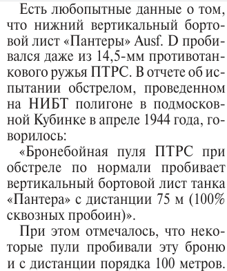

There is some interesting information that the lower side armour of a "Panther" D tank can pierced using the PTRS. The report on a ballistic test carried out in April 1944 on Kubinka's firing range says: "AP bullet from PTRS when striking at normal incidence pierces the vertical side armour of the "Panther" tank at 75m (100% perforations)" It was also noted that even some of the shots from 100m distance perforated the armour as well.
Source: "Maxim Kolomiec, "Panther" - the first encyclopedia of the legendary tank. (2013) "
