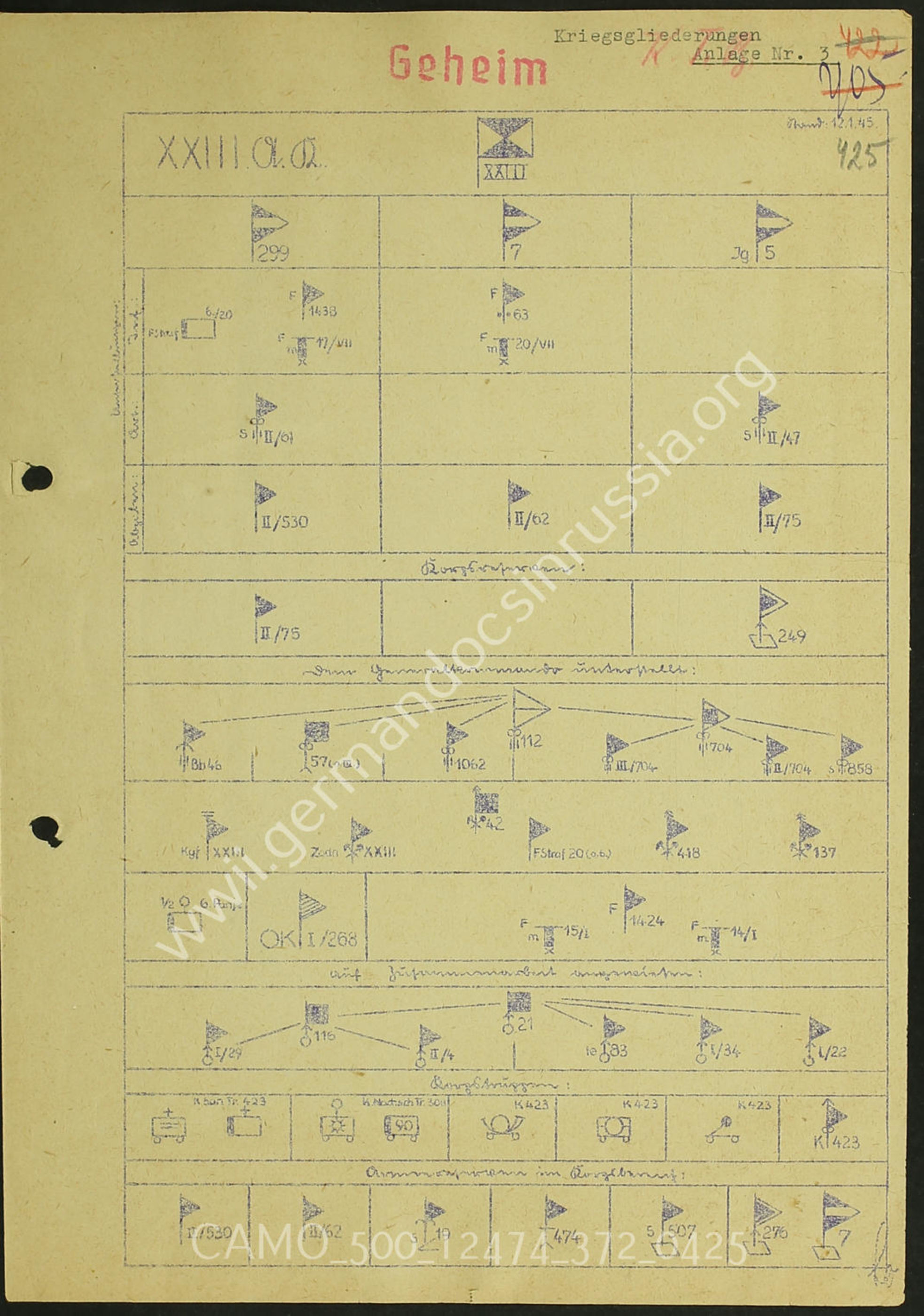

OOB of the XXIII AK 12.01.45:
http://wwii.germandocsinrussia.org/pages/365032/zooms/8

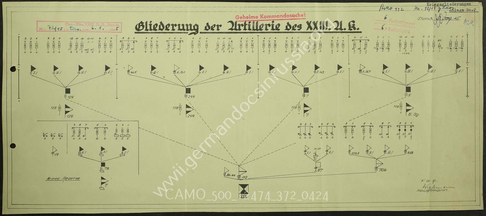

OOB of the XXIII AK's artillery, 5.01.45:
http://wwii.germandocsinrussia.org/pages/365031/zooms/8

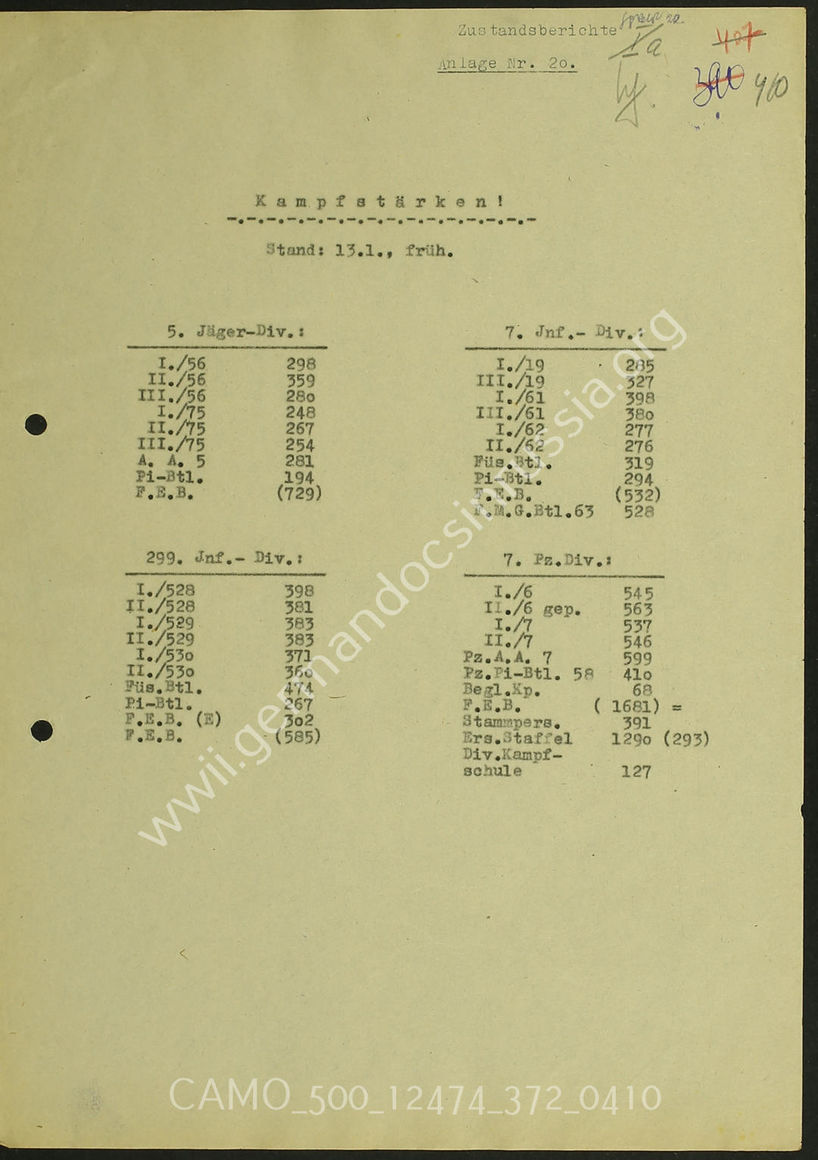

Battalion combat strength by divisions, 13.01.45:
http://wwii.germandocsinrussia.org/pages/365017/zooms/5

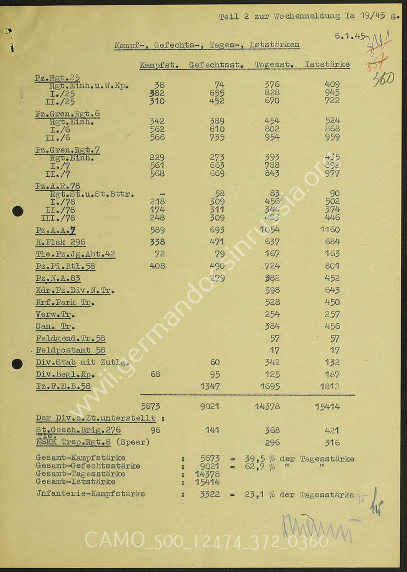

Personnel strength of the 7 PzD on 6.1.45:
http://wwii.germandocsinrussia.org/pages/364952/zooms/5

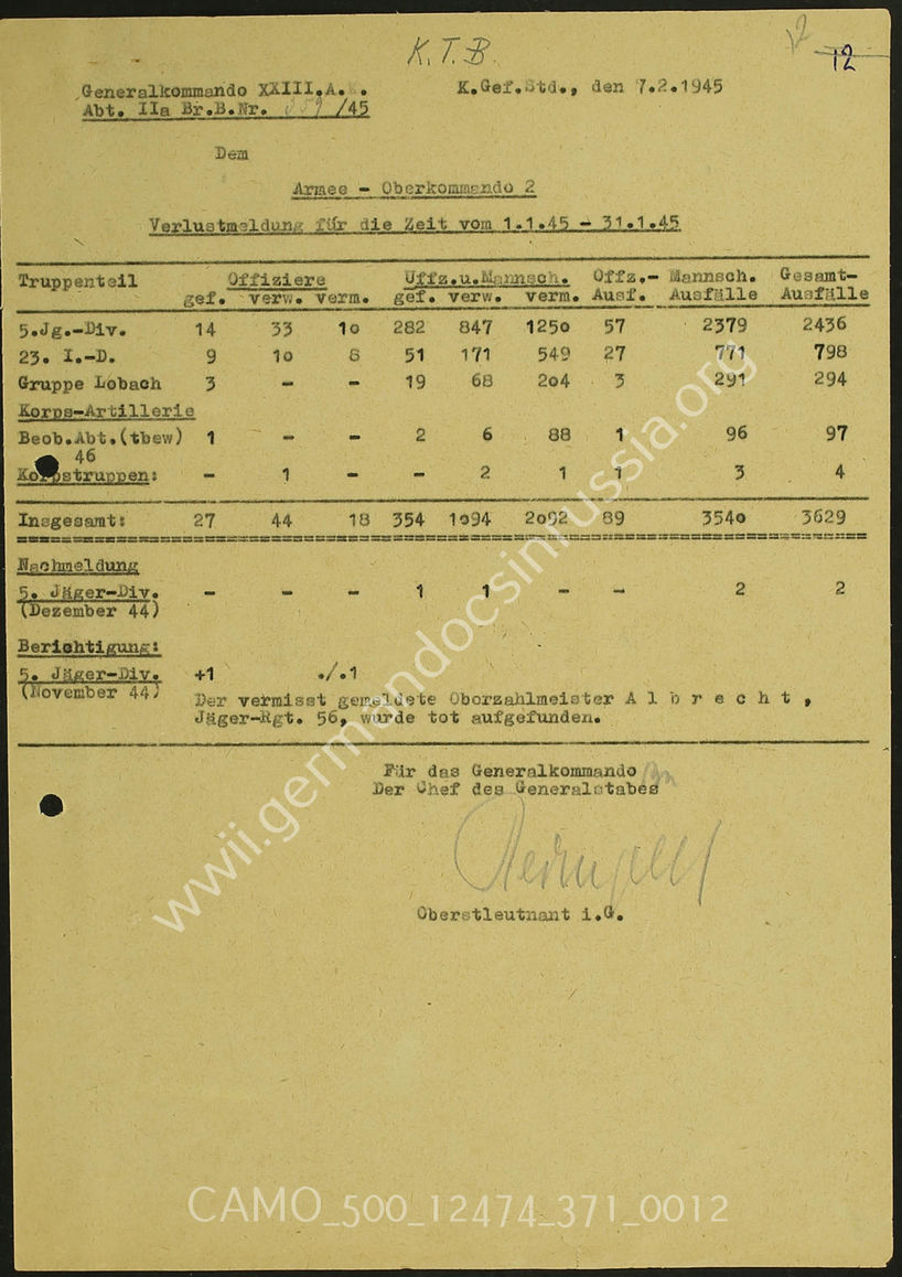

Personnel losses of the XXIII AK in January 45:
http://wwii.germandocsinrussia.org/pages/365057/zooms/5

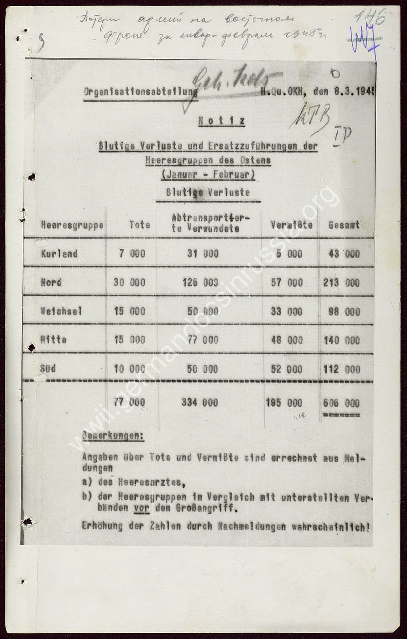

Regarding casualties: OKH counted more than 200 000 men killed, wounded and missing in HG "Nord" in January-February 1945 (not counting 2 Army which went to the HG "Weichsel"
http://wwii.germandocsinrussia.org/pages/179589/zooms/5
That was definitely a lot.
