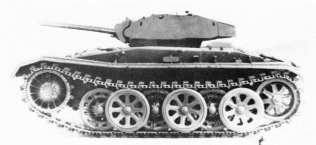

This is a very interesting website devoted to M24 and related AFV.
http://www.m24chaffee.com/m24-chaffee-home-page.html
Assigned M24
http://www.m24chaffee.com/us-units-that ... --m41.html
Period Photos
http://www.m24chaffee.com/m24-original- ... itary.html
My favorite
http://www.m24chaffee.com/prototype---g ... nsion.html
Assigned M24
Period Photos
My favorite
