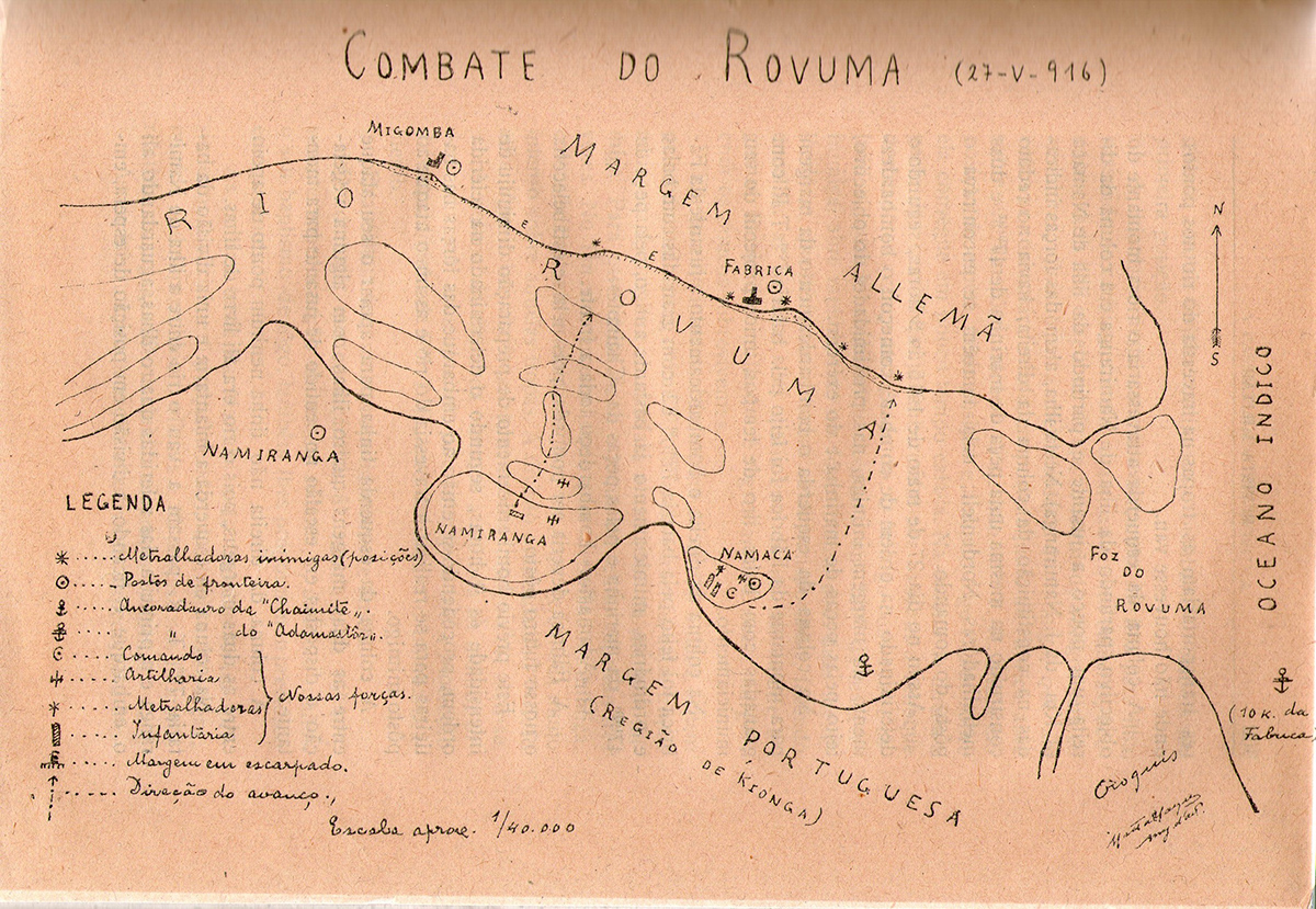

After a long search, I found the 02_photo in my archive from a pdf source that no longer exists.
Since I noticed this interesting picture years ago, I saved it only as a screenshot.
After further searching, I found publications of Portuguese artillery units. Under the heading:
"MEMORIES OF PORTUGUESE ARTILLERY" the story of the Artillery-Major Jorge Leopold da Silva is told.
“The main column, composed of 4180 soldiers (10 machine guns, 12 artillery pieces and the 10.5 cm Krupp
coastal artillery piece) crossed the Rovuma-River near the mouth and was supported by 3 artillery batteries
and the coastal artillery that came from Lourenço Marques after Namoto. In this operation, Major Leopoldo
da Silva demonstrated technical prowess and creativity in the use of mountain artillery and the heavy artillery
of the two ships, as well as the 10.5 cm Krupp coastal gun brought from Lourenço Marques to northern
Mozambique for the purpose. . . .”
Original Source: “Revista de Artilharia”, No 1112 – 1114, Abril a Junho de 2018, Major de Artilharia
Jorge Leopoldo da Silva, from Pedro Alexandre Marcelino Marques de Sousa, Pelo Tenente-Coronel
de Artilharia na Reserva and Professor na Academia Militar, página 9 - 14 (138- 143) Page 142
http://arquivodigital.defesa.pt/Images/ ... &img=57503
There are two concrete statements:
1.) 02_photo shows, as expected, the transport of the 10.5 cm S.K. L/35 gun barrel.
2.) The gun comes from Lourenço Marques (Maputo) and is referred to as a coastal gun.
Later more. . .

By "Bat. Marinha" is actually meant Marines (Batalhõe de Marinha), which were transported to Mossamedes by the "Beira". Documented in detail here:
http://www.momentosdehistoria.com/001-g ... lhoes.html
If the Namoto action in 1916 is as poorly documented as it was organized, then this is going to be an extremely tedious Sysiphus job.
(That's why I spent the weekend first recovering from the research by cleaning up storm damage with a chainsaw....)

17_Combate do Rovuma_27-V-1916_Escala 1:40,000
Scan of the original detail sketch of the Rovuma estuary in the smallest scale. The two parts of the river crossing
of the Portuguese armed forces on May 27th, 1916 are also shown. However, the north alignment (arrow) wasn´t
correctly displayed. Namiranga and Namaca were shown, but the settlement of Namoto itself, however, is already
positioned outside of the map.

18_Detail sketch Rovuma estuary in 1916
Source: https://www.operacional.pt/wp-content/u ... 0/0224.jpg
This map represents a subsequent correction of the upper map No.16. The river-island 'Ilha Chaimite' can be seen
on the bottom left. The Portuguese gunboat of the same name was probably named after it to indicate the Portuguese
claim on this island, the Kionga Triangle and this part of the Rovuma River.
Portuguese gunboat “Chaimite” 1898 – 1921: https://navios6.rssing.com/chan-10710347/all_p7.html
Article source: https://www.revistamilitar.pt/artigo/924
Direct map-source: https://www.revistamilitar.pt/recursos/ ... 48-439.jpg
