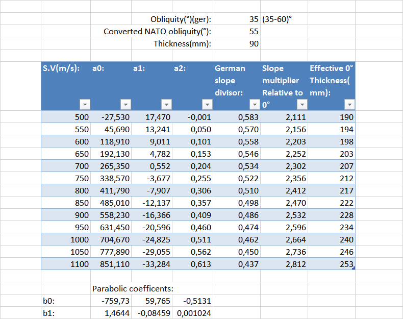

Peasant wrote:
29 Aug 2019 10:04
I've analyzed these curves and assembled them into a spreadsheet that can be used to estimate the slope multipliers for german projectiles not just at fixed velocities but any in-between those shown in the original graph.
Link: https://docs.google.com/spreadsheets/d/ ... sp=sharing
